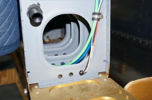

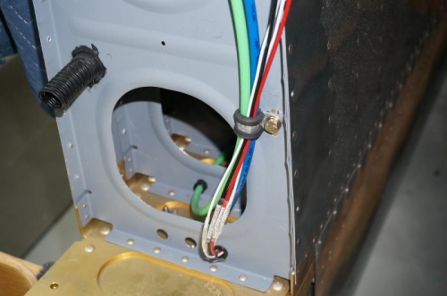

Brief Description:  Rerouted Pitot and AOA lines and wire harness in L
Installed a -3 nut plate in the root rib of the LH wing. Rerouted the pitot and AOA lines from second most inboard rib, through the forward lighting hole in the aft IB rib and through the clamp. This will allow the lines to enter the fuselage further after and not interfere with the aileron control rod.
Also routed the Pitot heat/stall wring wire harness thought the newly installed Adel
