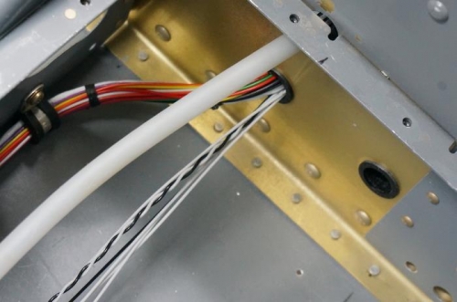

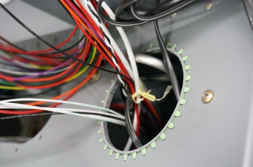

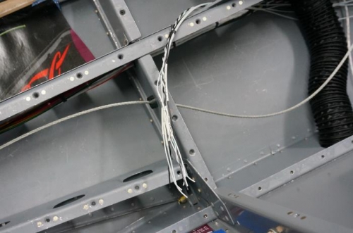

Brief Description:  Rear stick grip wire harness
Made the wire harness that will run from behind the panel to the CPC connector for the rear stick. Cut seven wires to length (trim U, D, L, R and ground and 2 PTT). Used a dill to spin two of them into a twisted pair for the push to talk switch. Labeled both ends of all wires. Tied the aft end with string ties and routed the harness through the RH gear tower, through the spar and aft to the rear stick position. The harness will be bundled with the main harness from the tailcone
