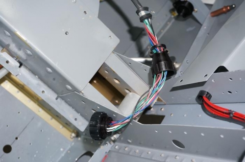

Terminating stick grip wiring
Removed plastic applicator from the click stud bonded to the front of the spar for the stick grip wire harness.
Did some rework on the CPC connector bracket for the pilot's stick grip harness.
Cut the pilot's stick grip wiring to length, installed D-sub connectors on each one and installed them in the CPC plug.
Realized that I had forgotten to put mesh sleeve on the harness so I removed all of the pins from the plug
CPC connector on pilot's stick grip wires
