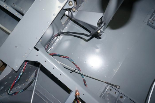

Covered the pilots stick end of the stick grip wire harness with shrink tubing and expandable sleeving.

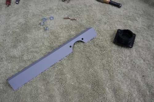

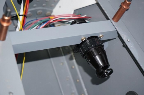

Fabricated an angle to support the CPC connector for the pilot's stick grip wiring. I want the pilots stick to be easily removable for maintenance of the switches and the CPC will facilitate that.
Bonded a click stud to the front of the spar under the RH midcabin brace cover. The click stud will be used to support an Adel clamp to hold the pilot's stick grip wire harness.
Pilots stick grip wiring
Bracket for pilot's stick grip wiring CPC connector
Bracket in place
Bracket in place
