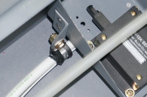

Completed fabrication of a bracket for Adel clamp to secure the main power cable to the roll trim servo bracket.

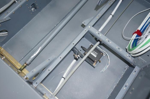

String tied the master contactor activate wire to the main power wire up to the point where they go through the spar.

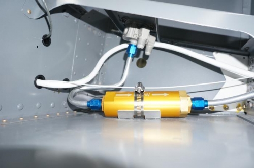

Mounted an Adel clamp stand off to the bottom of the fuel valve bracket. Bolted an Adel clamp in place to route the main power cable around the fuel filter and fuel valve
Main power cable  routed under roll trim bracket
Adel clamp bracket for main power cable
Main power cable  routed through fuel valve area
