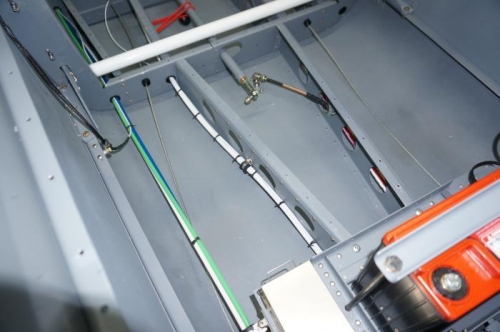

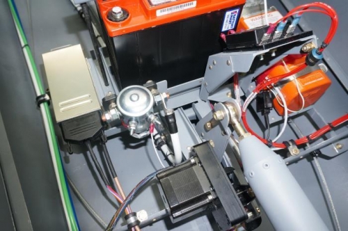

Brief Description:  More main power cable installation
Finished string tying the master contactor activate wire to the main power wire. Reinstalled the battery tray and attached equipment. Connected the main power wire to the master contactor.
Re-installed the fuel valve, aux fuel pump, the fuel filter and the fuel lines in order to plan out the routing for the main power wire as well as the pitot-AOA tubes and other wires that will run under the fuel valve support. Began looking at options for routing the various wires and tubes.
Main power wire and master contactor activate wire
Main power wire connected to the master contactor
