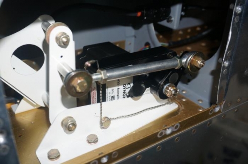

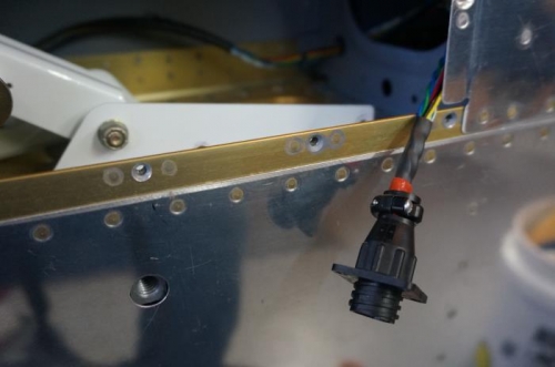

Routed autopilot roll servo harness through the snap bushing and inserted the pins into the CPC connector. Bolted the CPC connector to the connector bracket and blind riveted the bracket to the wing rib.
Removed the aileron bellcrank from the RH wing, lubricated the bushing with Aeroshell #6 and replaced the bellcrank. Installed the AP roll servo, Safety wired it (took two tries) and installed the linkage.
Autopilot CPC pin connector
CPC bracket in place
Completed servo installation
