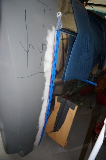

Removed the RH wing tip from the wing. It came off easily with just a gentle bump from my palm on the aft end of the tip. I installed it back on the wing and since the tip didn't get bonded to the wing in the previous step I mixed up another batch of dry micro and filled the remaining tip to wing gaps on both wings. I also faired the tips in some spots to blend the contour from the wing to the tip.

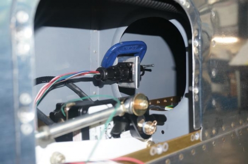

Installed the roll servo linkage.

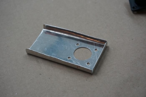

Fabricated a bracket to hold the flanged CPC connector for the roll servo wire harness. Test fit the bracket on the first aft wing rib outboard of the bay with the roll servo. Clamped the bracket in place.
Micro curing in LH bottom wing tip gap
Bracket for roll servo wiring CPC connector
