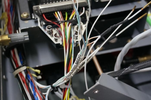

Cut to length the remaining wires that connect to the SV-EMS-220. Terminated them with D-Sub receptacles. The two power wires for the trim servos were solder spliced together and to a long 22 gage wire that will be used to power some of the engine sensors.

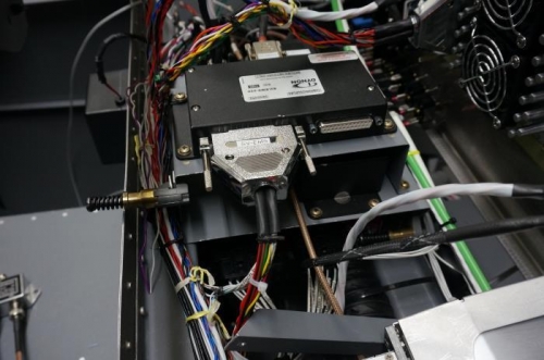

Installed the D-Sub receptacles in the connector and reassembled the connector backshell.
EMS wiring
EMS wiring
Completed SV-EMS connector
