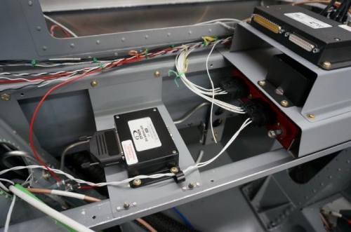

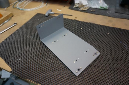

Scuffed cleaned and primed the shelf for the SV-ARINC4239. Riveted nut plates in place.

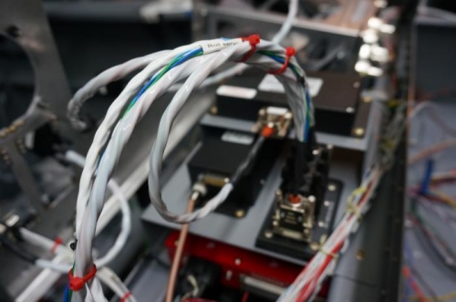

Cut one of the 3 foot SV network harnesses in half and terminated the end of one with a D-sub connector. Installed the harness between the SV-EMS-200 and the network hub.
Installed labels on many of the SV network cable connectors.
