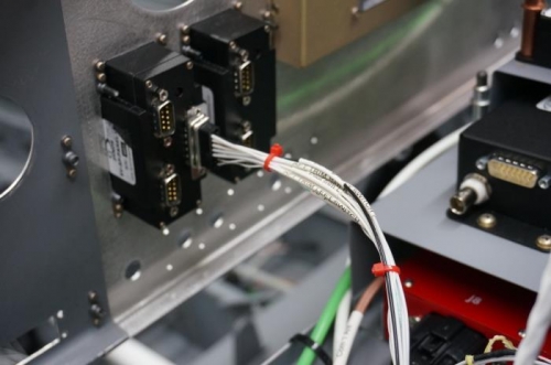

Wiring work. Cut and terminated all but two of the wires for the autopilot panel with D-sub sockets and plugged them into the D-sub connector. The remaining two wires are for the roll trim servo which route through the LH gear tower. Those two will be routed after I work out the harness routing from the LH gear tower. Hooking up the pitch servo involved installing a solder sleeve with pigtail on the five conductor wire and soldering an extension wire to the pigtail to route it to the grounding block.

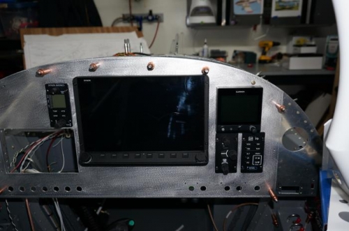

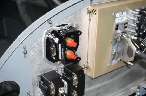

Installed the Garmin G5 in the panel
Autopilot wiring
Autopilot wiring
Garmin G5 installed
Garmin G5 installed
