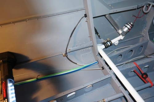

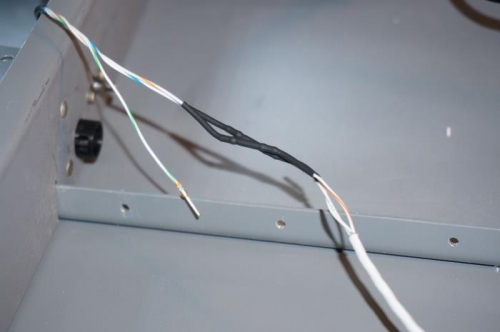

Installed male and female D-sub connector pins on the three pigtail wires coming from the flap position sensor and the three conductor shielded wire that connects it to the VP-X pro. Connected the pins together and shrank heat shrink tubing over each one. Installed expandable sleeving over the part of the wire that runs behind the aft baggage floor.
Installed molex pins and a two pin connector on the pigtail wires from the flap motor.
Installed a standoff and Adel clamp to support the wire.
