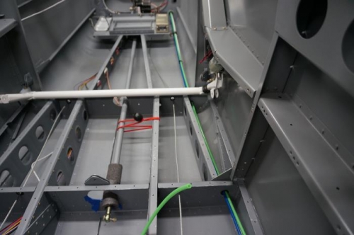

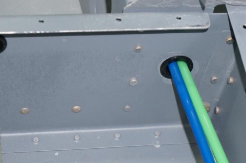

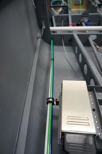

Pitot-Static-AOA line routing
Drilled holes through two of the lower bulkheads and installed snap bushings. Routed the pitot-static-AOA lines through the snap bushings.
Installed a standoff of the battery tray for an Adel clamp to support the lines.
Lines routed to mid fuselage
Lines clamped to battery tray
Lines passing through bulkhead
