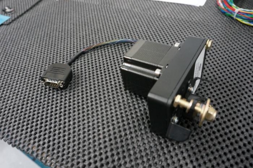

While installing the D-sub pins and connector on the wire harness for the autopilot pitch servo last night I discovered that the pinout for the roll servo in the wing was wrong. I'm not I referred to when I wired that but it didn't match the most recent Dynon Skyview installation manual, so tonight I removed the pins from the connector and reinserted them per the wire diagram in the manual.
Removed the autopilot pitch servo from its bracket and installed the male D-sub pins and connector on the wire pigtail comming from it.
D-sub connector on AP pitch servo wires

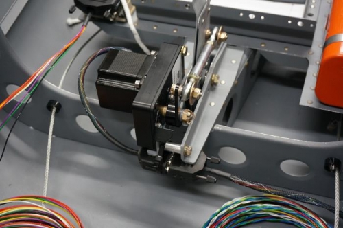

Trial fitting AP pitch servo
