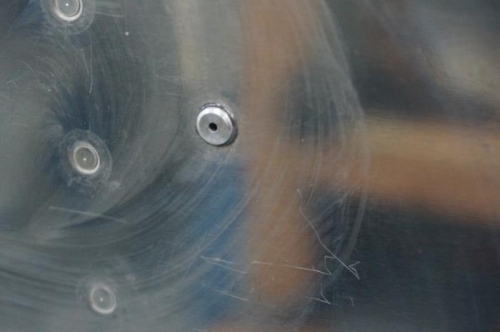

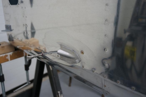

Prosealed the static ports and rudder cable exit fairings in place. Riveted rudder exit covers.

2x4 applying bonding pressure to static ports
OML view of static ports
Rudder cable exit fairings
