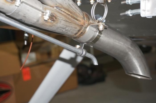

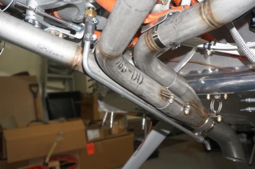

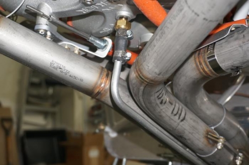

Brief Description:  Sniffle valve
Installed the sniffle valve in the bottom of the engine sump. Bent an aluminum tube to match the angle of the exhaust and connected it to the sniffle valve with a short piece of rubber hose. Installed hose clamps on both ends of the hose. Fabicated a zee from 4130 steel and secured it to the exhaust collector with a hose clamp. Bolted an Adel clamp to the zee to secure the aft end of the sniffle valve outlet tube.
