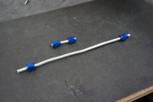

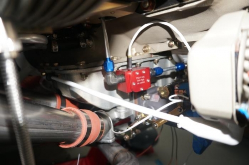

Brief Description:  Red Cube part 1
Fabricated mock up fuel lines to determine what length fuel hoses I need to order from TS Flightlines for connecting the fuel servo outlet to the inlet of the fuel flow sensor (the red cube) and the fuel flow sensor output to the fuel divider. Temporarily installed the sensor and lines in place on the engine to check fit.
Removed the sensor and lines and measured the flare to flare distance of each. I need one 2 1/4" long and one 10 7/16" long. Sent an email to TS Flightlines to order the parts.
Mock up fuel lines
Mock up fuel lines
Red cube temp installed
