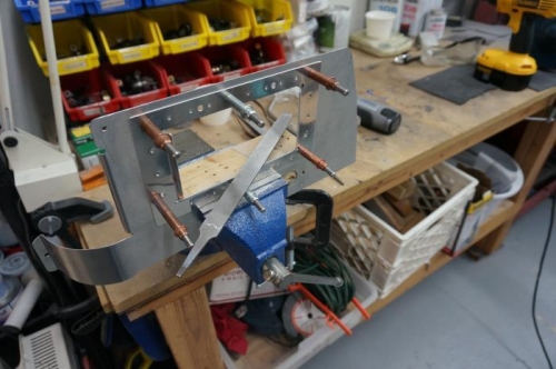

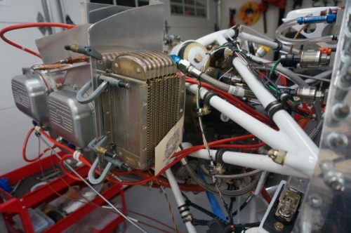

Cut the oil cooler opening in the left hand rear baffle. Installed the baffle on the engine.
Temp installed the 90 deg fittings in the oil cooler and clamped the cooler to the baffle.
Hooked up the oil lines to the oil cooler to assess the routing.
Cutting opening for the oil cooler
