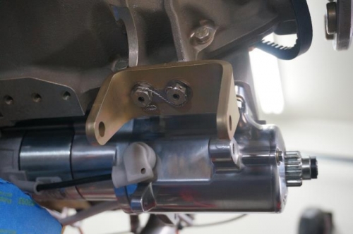

Bolted the alternator mounting bracket to the engine and safety wired the bolts.

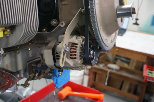

Removed the fly wheel and installed the alternator drive belt. Replaced the flywheel
Installed the alternator arm bracket.
Installed the alternator. Hand tightened the bolts.

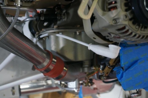

Terminated the end of a #6 cable with a ring terminal and attached it to the power output (B-lead) stud on the alternator.
Routed the B-lead cable along the right hand side of the engine sump. Installed an Adel clamp to one of the sump bolts to secure the cable.
Secured the B-lead cable to the engine mount on the lower right hand side.
Alternator mounting bracket
Alternator in place
Alternator B-lead
