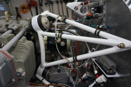

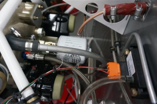

Connected the fuel pressure sense line to the engine. Torqued and torque sealed
Installed the oil breather line. Adel clamped the hard line to the firewall. Hose clamped the flexible hose elbow to the engine fitting and the hard line.
Connected the oil cooler return line to the engine. Torqued and torque sealed
Connected the fuel hose to the inlet side of the engine driven fuel pump. Torqued and torque sealed
Oil breather tube
Oil breather tube
Fuel supply line
Fuel supply line
