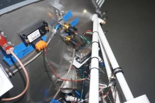

Replaced most of the zip ties forward of the firewall with string ties.

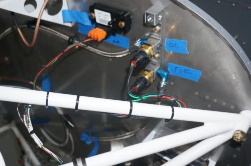

Spliced and terminated wires to hookup the manifold pressure, oil pressure and fuel pressure sensors.
Booted up the skyview system and verified that the oil and fuel pressures read zero and the manifold pressure read ambient pressure (30.1)
String ties on wire bundles
Manifold, Oil and Fuel pressure sensors hooked up
