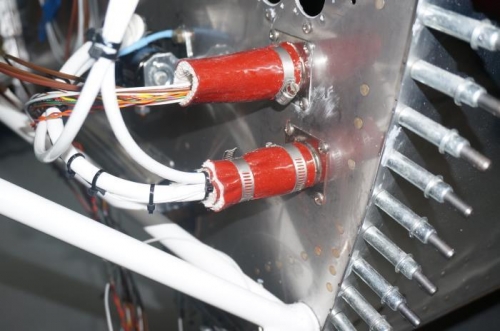

Another firewall passthrough
Applied epoxy/micro to the wing tips
Drilled holes and installed another 1 inch firewall pass through. This one is on the LH side of the firewall and will be for the wires for the sensors and equipment on the LH side of the engine and firewall.
Wire bundle for LH side of FW and engine
