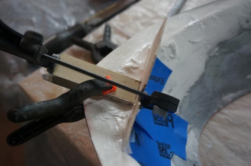

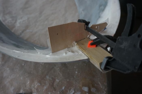

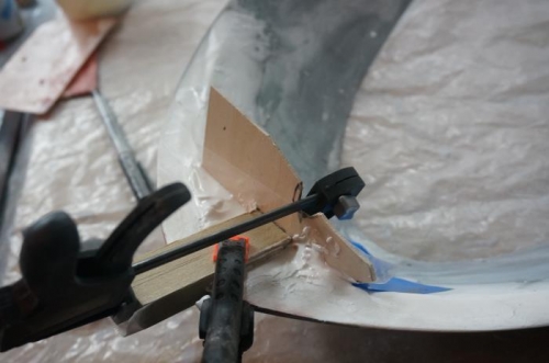

Canopy skirt aft tunnel
Continued shaping the top of the tunnel area at the aft end of the canopy skirt
Fabricated a shaping tool to form the final shape of the inside of the canopy skirt aft tunnel. Clamped it in place and filled the open area with epoxy/micro
