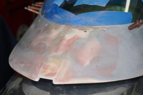

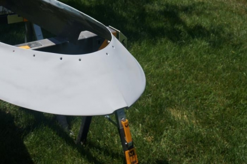

Sanded the aft end of the canopy skirt and applied spot putty. When that dried I sanded it and then sprayed the aft end of the canopy with high build primer.

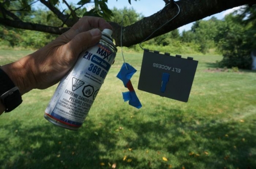

Sprayed clear coat over the labels on the ELT access door and the canopy latch.

Micro and spot putty sanded
High build primer
High build primer
Clear coating lables
