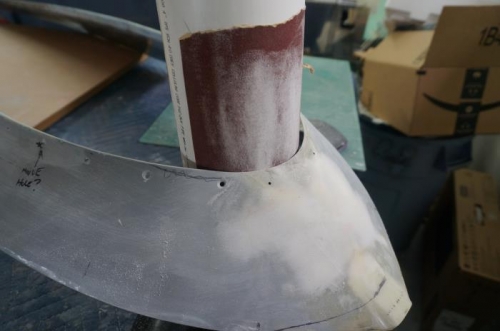

Sanded the latest micro on the canopy skirt. Sanded the upper aft edge of the canopy skirt using a piece of 4 inch PVC pipe which resulted in a nice smoothly curved edge. Applied flox to two of the holes in the canopy skirt that were oblong.

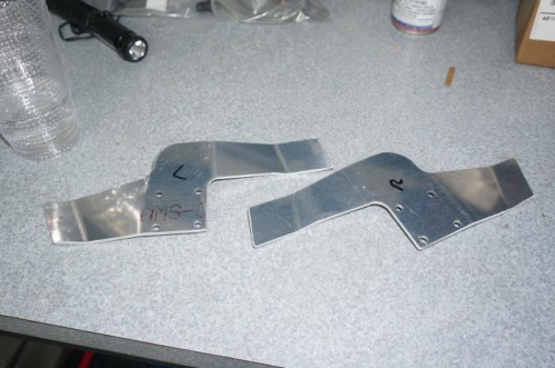

Deburred the inboard wheel pants brackets.

Sanding the canopy skirt
Deburred wheel pant brackets
