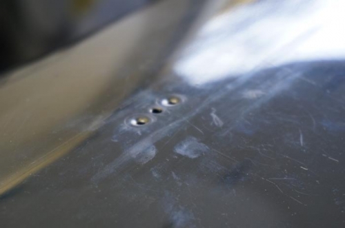

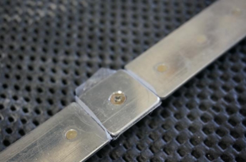

Removed the canopy rail and cut out a 1 inch section of the top cap at the second most aft mounting screw location. Fabricated a replacement piece which will be held in place by the rail mounting screw. Drilled holes in the skin for a #6 nut plate at the same screw hole location where the top cap section was removed. The above was done to create a removable section of the cap that will allow the canopy to be removed from the aircraft without removing the empennage fairing.

Modified canopy rail
Holes for nut plate for removable section
