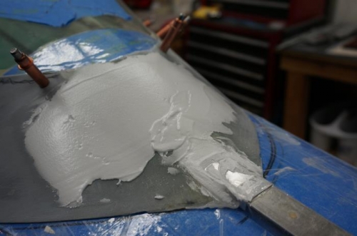

Sanded the aft end of the canopy skirt to scuff it up for micro
Applied dry micro to the aft end of the skirt to fill in low spots near the top end for radii at the sides of the slider rail at the aft end
