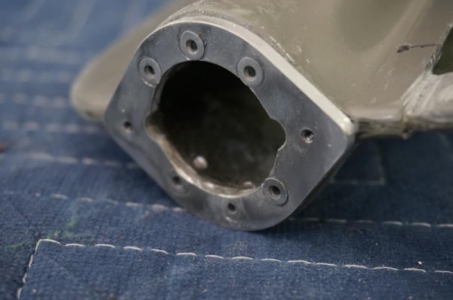

Drilled and cut the aft end of the rudder bottom for the tail light mount that I purchased from Cleaveland tools. Riveted the mount in place.

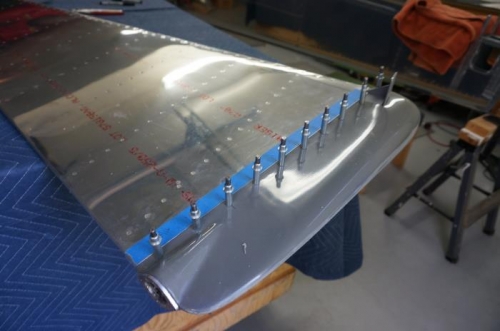

Fabricated aluminum strips to reinforce the fiberglass rudder tip. The flanges on the pre-fabricated fiberglass tip were a little short so the holes that were drilled to that the ones in the rudder skin ended up with short edge distance. Hence the need or the reinforcement strips. Drilled the strips to match the rivet holes in the cap. Drilled #40 holes in the tip and reinforcement strips. Counter sank the cap and installed flush rivets. Mixed up some epoxy/flox and spread it on the exposed edges of the reinforcement strip to extend the edge of the cap
Removed the rudder and vertical stabilizer.
Drilled the remainder of the mounting holes for the rudder bottom.
