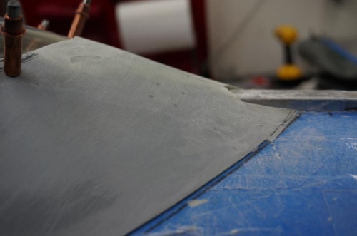

Sanded the patch I laid up last night. Removed The skirt and trimmed the top edge. The plies were too dry. Probably because I squeegeed off some of the resin after I laid it up. I was able to rip off some of the plies that didn't stick well. Sanded the area and might layup more plies or I might put a layer of micro to finish it off.
Trimmed off the plies around the canopy rail. This are will need micro to form the radii.
