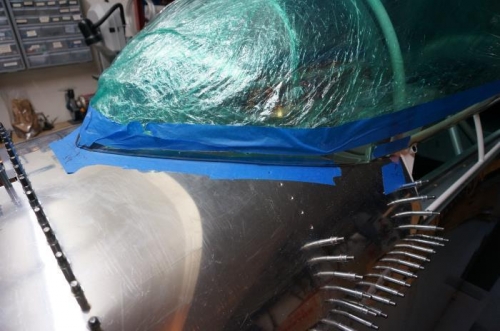

Brief Description:  Canopy bubble trimming part 2

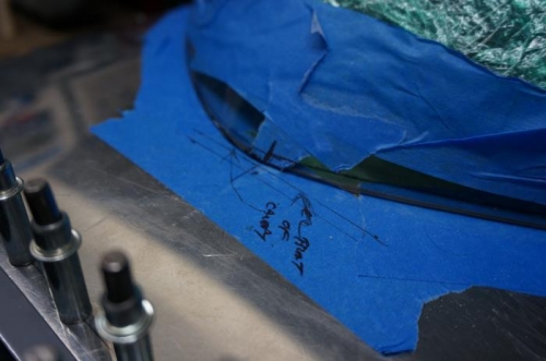

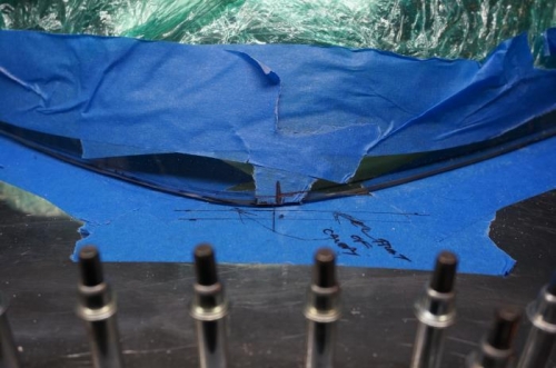

Made a couple more cuts on the front of the canopy to bring in down further. Cut the aft parts of the canopy that were touching the aft fuselage upper skin.
Bought a new belt sander and used it to sand the cut edges of the plastic with 80 grit and then 120 grit. Used a scotchbright wheel in the die grinder to smooth the edges.
