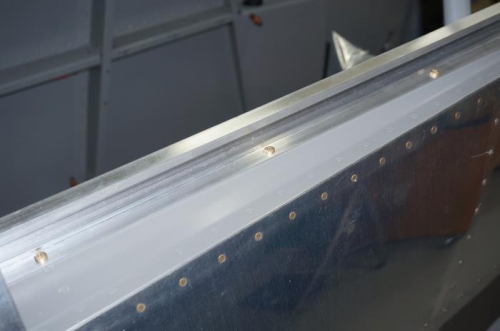

Finished drilling the mounting holes for the canopy rails.

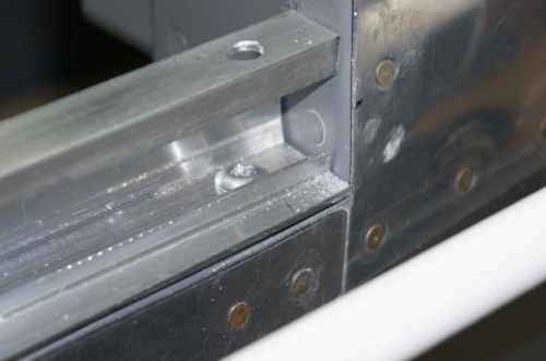

Finished shaping the aft end of the rails to match the curvature of the fuselage sides.
Cut a relief notch (per the plans) to allow the aft most screw in the RH rail to bottom out. The LH side didn't need one.

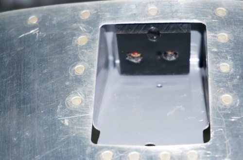

Drilled the holes for the screws that secure the canopy anchor block to the F807 bulkhead. Dimpled the holes in the bulkhead. Countersank the holds in the forward side of the anchor block and counter bored the holes in the aft side of the anchor block.
Installed the anchor block
LH side canopy rail fastened in place
Aft end of LH rail
Aft end of LH rail
Anchor block
Anchor block
