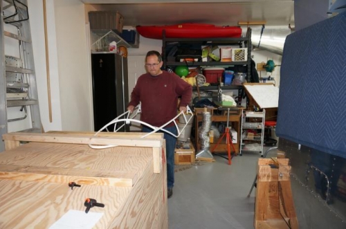

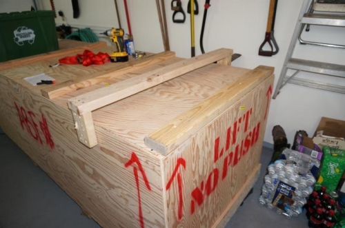

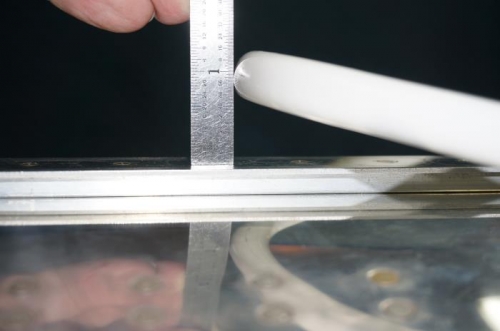

Screwed some scrap 2x4s to the top of the finish kit crate to make a bending jig for tweaking the aft end of the canopy frame. The plans call for the aft most part of the frame to be 5/8 to 3/4 inch from the top of the canopy rail. Out of the box mine was over two inches. By putting the aft end in the jig and pushing down on the middle of the frame I was easily able to bend the frame the required amount.
Canopy frame bending jig
Bending the aft end of the frame
Height from the top of the rail right n the middle of the spec range
