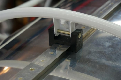

Drilled the slider block for the clevis pin.

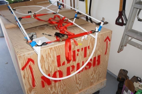

Fabricated aluminum strips to tape/clamp to the frame to help determine what adjustments need to be made.
Used ratchet straps to pull the front bow of the canopy frame closed to match the fuselage. Did this numerous times with fit checks in between.
Slider block drilled for clevis pin

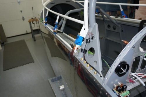

Fitting the canopy
A little tweeking
