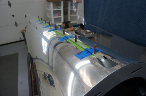

Laid out the location of the canopy slider spacer on the top centerline of the aircraft. Taped the spacer in place.
Drilled the 9 mounting hole locations through the spacer into the fuselage skin.
Countersank the 9 mounting hole locations and opened them up to #28 for #6 screws. Opened up the holes in the skin to #28.

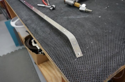

Riveted the slider cap to the spacer

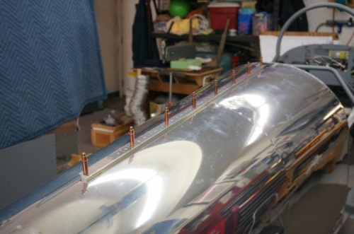

Clecoed the slider rail to the fuselage and started bolting it in place.
Slider spacer located on tailcone with screw holes drilled
Canopy rail riveted together.
Slider rail clecoed in place.
