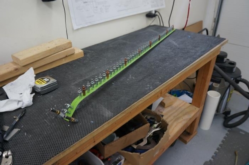

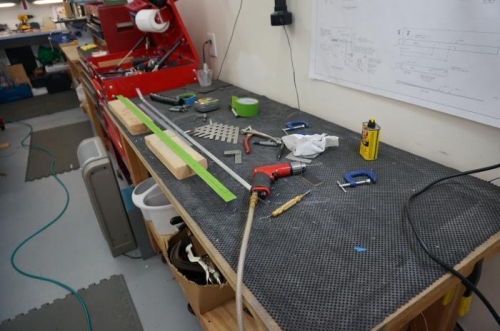

Continued fabrication of the canopy slide spacer and slide cap. Finished bending the cap to match the spacer. Laid out and drilled all of the holes for the rivets which will hold the two parts together as well as the holes for the bolts that will attach the assembly to the fuselage.

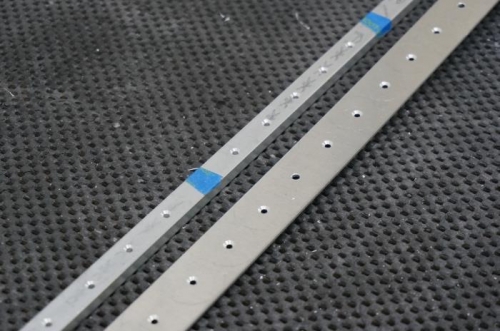

Deburred all holes
Machine countersank the 3/32 rivet holes.
Drilling the holes in the canopy rail cap
Counter sunk
Counter sunk
