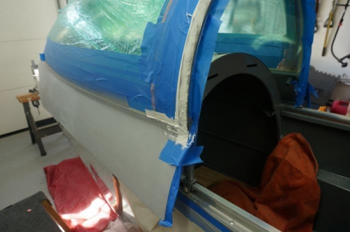

More canopy work
Sanded the flox on the forward end of the canopy. Applied micro over the sanded flox
Fabricated strips to close out the forward and aft ends of the baggage door hinge
Wet sanded the canopy skirt and painted it with a coat of UV smooth prime
