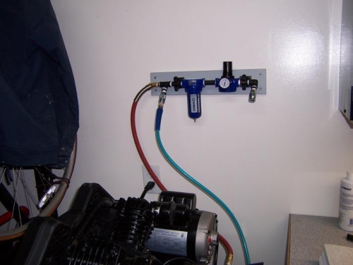

Brief Description:  Filter and regulator for compressed air
Put together a filter/regulator setup for the air compressor. It provides for full tank pressure (~120 psi) for blowing air and running air wrenches, filters out particulates and water and provides a better regulator/gauge than the ones provided with the compressor.
