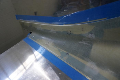

Brief Description:  Filling gaps under empennage fairing
Removed the empennage fairing. Sanded IML and applied micro in the areas that didn't make solid contact to the VS and HS. Reinstalled fairing for cure.
Laid up some plies on the lower aft edge of the windscreen fairing to extend the lenght
Installed a 6-32 thread insert in the LH forward most empennage mounting hole. I had drilled this hole to #28 which is the clearance hole size for a #6 screw rather than the size required for tapping.
