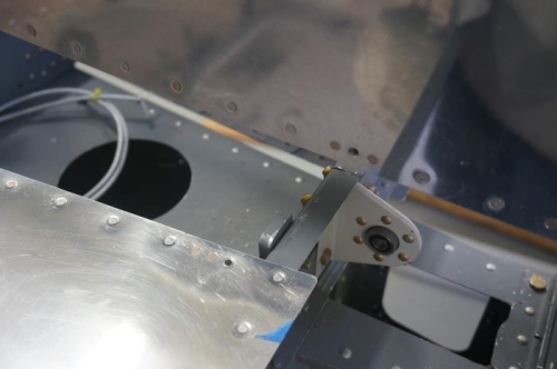

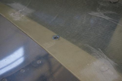

Removed the elevators, rudder and Vertical stabilizer. Installed nut plates along the bottom edge of the vertical stab and the inboard edges of the horizontal stabilizer for #6 screws to hold the empennage fairing in place.
Drilled and tapped one additional hole for the top edge of the elevator horn access covers
Nut plates installed
