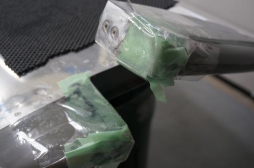

Elevator counterweight closeouts
Laid up two plies of fiberglass over the plywood closeouts on the horizontal stabilizer tips and the front of the elevator tips.

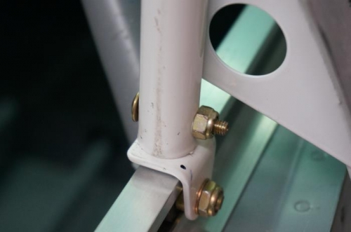

Drilled the #10 holes through the canopy frame and roller support for the two retaining bolts.
Fiberglass on empenagel tips
Canopy roller retaining bolt
