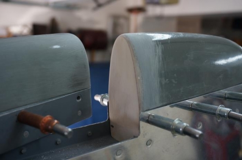

Sanded the plywood closeout on the vertical stab tip to shape

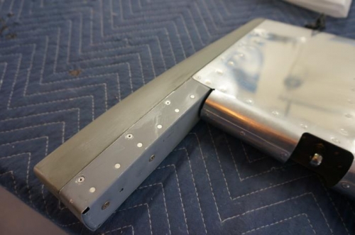

Applied a layer of T-88 structural adhesive to the rudder tip cap and the rudder flange (after cleaning and scuffing the bond lines) and clecoed the tip in the rudder. Installed the blind rivets

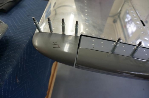

Installed the elevators in the horizontal stab and clecoed the elevator tips in place.
Trimmed the horizontal stabilizer caps to fit. Laid out the rivet hole locations and match drilled the skins and tips.
Vertical stabilizer tip closeout
Rudder tip riveted
Rudder tip riveted
Horizontal stab tip in place
