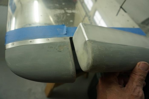

Sanded the LH HS and elevator tips. The gap between them is now 3/16" which is within spec.

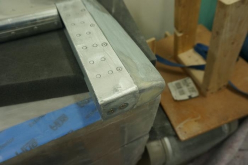

Trimmed 1/8" off of the aft end of the RH HS tip. Cut a new plywood closeout and floxed it in place.
Sanded the tip of the RH HS
LH HS and Elevator tips after sanding
RH HS tip with replacement plywood floxed in place

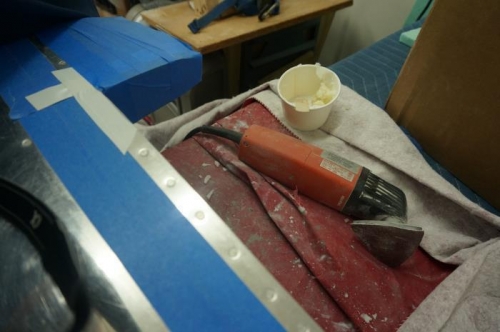

RH elevator tip ready for micro
