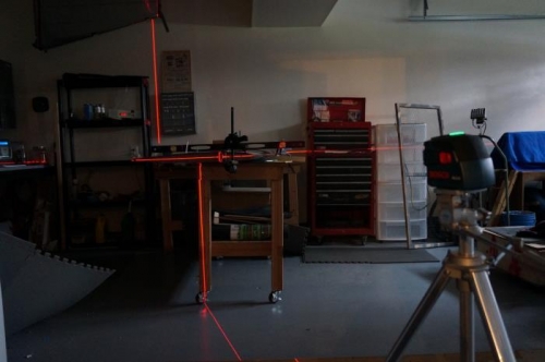

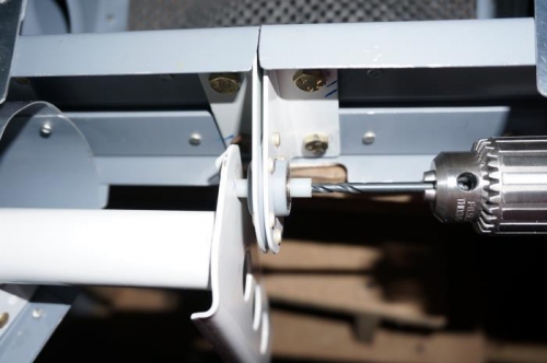

Used lase level to check HS and elevators for straightness and in-trail postion. Everything looked acceptable. Readjusted elevator rod ends to mid point of acceptable range. Reinstalled elevators and drilled holes in elevator horns for centerbearing bolt. Used nylon spacered from Home Depot for drill bushing. Sleve OD was 1/4 inch but it didn't fit into bushing so I chucked t up in my drill press and used sand paper to reduce the OD until fit.

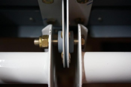

Reinstalled the elevators and loose installed the center bearing bolt which fit very well.
Checking for straightness with laser level
Drilling control horn for center bearing bolt
Center bearing bolt loose installed (without the center washers.
