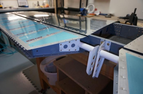

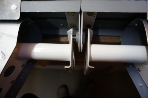

Began fitting elevators to the horizontal stabilizer. Fabricated pins from 3/16" rod for holding elevators in place at rod ends. Installed elevators on HS. Trimmed LH top outboard HS skin for clearance from elevator.
