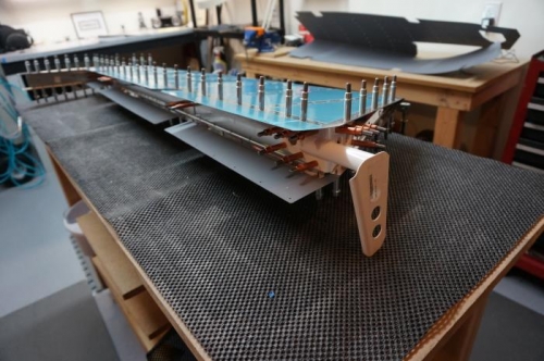

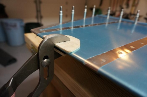

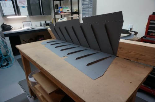

Right elevator stiffeners, TE and match drilling
Backriveted the RH elevator stiffeners to skin. Bent the trailing edge. Match drilled the elevator horn to spar and rib. Match drilled skin to spar and ribs.
