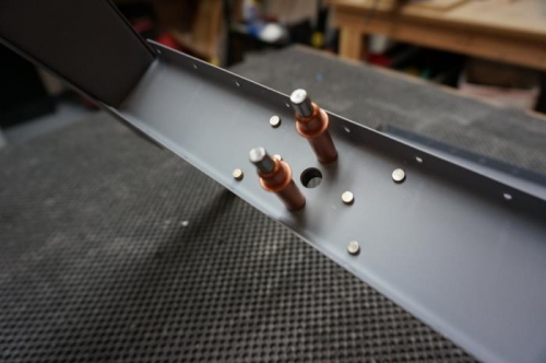

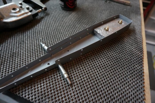

Riveted the rudder counter weight skin to the upper rib. Drilled, countersank and dimpled the counterweight. Temporarily installed the counterweight and removed. Began riveting substructure together
Counterweight installed
