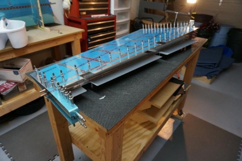

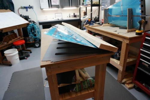

Bent the rudder trailing edge closed with the wooding bending brake I made per Van’s instructions. I couldn’t get the TE closed far enough with the brake so I finished the bend with channel locks. Assembled the skin to the substructure and final drilled. Disassembled. The edge dimension on the dreaded rudder horn brace looks good.
