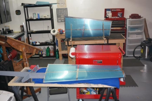

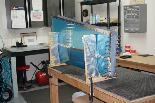

The oops rivets I ordered came today so I dissassembled the VS since its ready for reburring, and continued final assembly of the RH HS. I opened up the oversize rivet hole and installed an oops rivet which turned out well. Then I clecoed on the outboard end rib and the aft center rib and then riveted the bottom rivets on the forward center rib.
RH skin on workbench with LH and fwd spar in foreground
RH skin build up
RH skin build up
