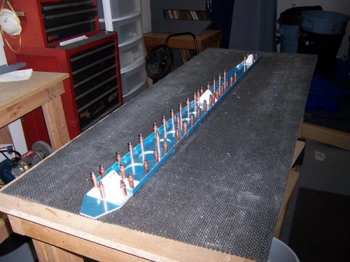

Finished deburring the replacement LH rear HS spar, scuffed and dimpled it then primed it along with the inside of the RH skin. Drilled out and reinstalled two rivets holding the upper reinforcement angle to the fwd spar. I had used the squeezer previously and they were both smeared a little. This time I bucked both and they look good. There are another 4 or 5 that need to be replaced. I'll do them in the next build session or two.
Started on the VS rear spar. Clecoed the rear spar to the doubler and rudder hinge brackets per step one.
VS rear spar initial build up
