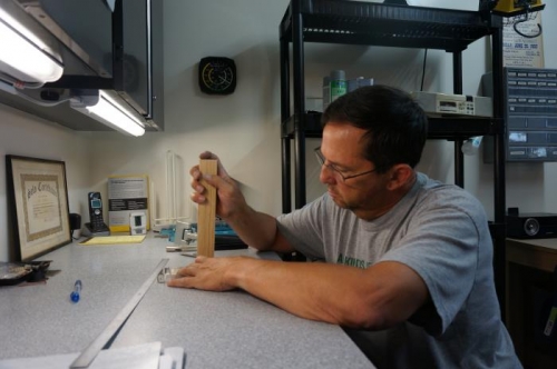

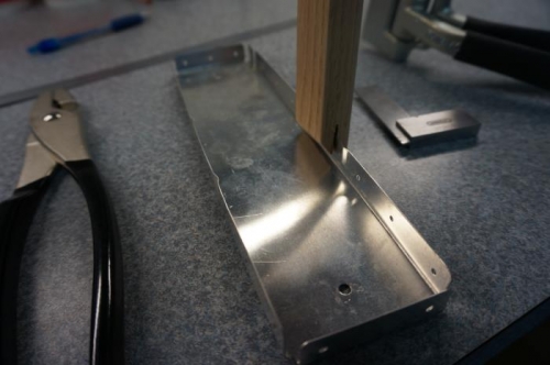

Started bending and fluting rib flanges.
Measured squareness of rib flanges and bent to square as required. Made a bending tool out of hardwood (got the idea off of another builder's site). Fluted as required to straighen webs.
Checking flanges for squareness
Flange bending tool
Bending flanges
